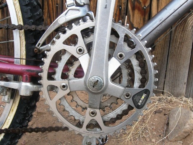

Hey folks, just got my first Fat Chance today from a guy looking to sell a bike from a friend, and who knew absolutely nothing about it. As for me me , I was totally clueless about Fat Chance, until I did some web research before buying it. Not being one to turn down a really cool and legendary old-school MTB for $20, I grabbed it. I know it's an '86 from the serial #, but I can't find one just like it on the web. It's got the Shimano Deerhead derailleurs, Shimano cranks, the Magura brake levers, Suntour shifters, Biopace chainrings and the under-chainstay mounted rear brakes. Front hub is shimano, can't read the rear, 6-speed rear cogs. What do you think? Any info appreciated. The bike is very rideable (except the seatpost is sticking like a bear), and I'm anxious to fix it up.

Great deal on a great bike. Is it your size or are you going to flip it?
Value-wise, I'd say $450-$600. The paint is a feature - that's not normal.

Thanks for the reply. The size, I think will work for me. It's on the edge. I have to feel it out a little more. Does it have a model name? Is it a 'Kicker', by chance. When you say 'the paint is a feature' what exactly do you mean, that it's a custom job?

Yeah, it's a Kicker.
The paint would have been requested. I've never seen one like it, but it looks right.
Here's my assessment
I believe it is an '88 Fat Chance and not an '86. I started at the end of 1986 and all of those bikes had seatstay-mounted brakes. The rear brake appears to be a roller-cam and not a Shimano U-brake. When the chainstay-mounted brakes came out (1987, I think) we primarily installed them on the Fat Chance models and the Wickeds got seatstay cantilever mounts.
I believe Shimano came out with those silly "Biopace" chain rings in 1987 also
As for the paint, it appears to be a knock-off of the 10th Anniversary model paint scheme but with solid black decals instead of the black outline type used on the 10ths. I would like to see a photo of the bottom of the bottom bracket. If the frame has a plastic rivet-on cable guide then it is definitely not an '86 model.
When we came out with the Wicked in 1987, we dropped the "kicker" name from the regular Fat Chance.
It is hard to tell exactly from the photo, but the frame appears to have the 69 degree head angle and 2" rake fork which would be on the Fat.
Post a close-up of the serial number if you can. I am betting that there is an 8 on the end and not a 6. Still, an extraordinary find for $20 - lucky bastard

Thanks Scott for weighing in. You'll have to trust me on the serial number. It is 86375, You probably couldn't make it out in a picture anyway. It's very hard to see whether the second number is a 6 or 8, but I can definitely see here that it's a 6. And the chain guide at bottom is metal and part of the bracket. Definitely not plastic.
'It is hard to tell exactly from the photo, but the frame appears to have the 69 degree head angle and 2" rake fork which would be on the Fat.'
What do you mean here, on the 'Fat." Which model are you referring to. The rear brake is a Suntour XC power, a roller cam type I believe. Lucky? You don't know the half of it. It's a funny little story. So let me know further thoughts. Thanks for the help, Rchard

Those parts are much more '86 than '88, and the rings woudl be something pretty common to replace (as opposed to the brakes and mechs).
Nice pick up! I like the color scheme too, but it of course preceded the 10th scheme by a number of years.
85 Fat
it looks like the rear derailleur cable is run on top of the bottom bracket, is that correct?
Scott, correct me if I am wrong, but that would be more 86 than 88, yes?
Neat looking bike, certainly a great deal at the price
Since you say that there are metal cable guides on the BB, then indeed it would be an '86.
Since I came along late in '86, they obviously built some chainstay-mounted brakes before I got there. Must be that old smoky shop thing again:cool:
I stand corrected.
I do think the paint is not stock, though.
Still, neat find!! Have fun

Thanks again, folks, for all the input. So, I'm comfortable with the description of this bike as an'86 Fat Chance, plain and simple. Any more thoughts on the paint job? Stock, custom, or user mod? Seems like nobody has seen one like it, so that aspect is pretty intriguing. I don't see any evidence that it's not a factory job, but maybe there is something I could look for that would indicate that.
I think we'd all say the same thing: better pictures might work and a painter's decal, mark or signature would seal the deal.
I know it's a little thing, but I called it legit - factory - because of the tubing decal. Something a restorer might take in to consideration, but not something I'd expect from a repaint-because-it's-looking-a-little-tired.
